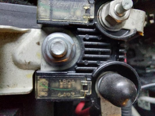

RamDiver
Jan 23, 2022
5,570
11,758
Marlborough, Ontario Canada
2021 DS
The battery is to the left of where the picture was taken with the front of the truck being above.
The left side in the picture is the battery bracket attached to the positive battery terminal.
In view, the upper fuse value is 120A and the lower 180A. The large wire lug terminals to the right would be a good location to test if the fuses are functional or open.
This picture is from my '21 Warlock, yours may look a bit different. :cool:
