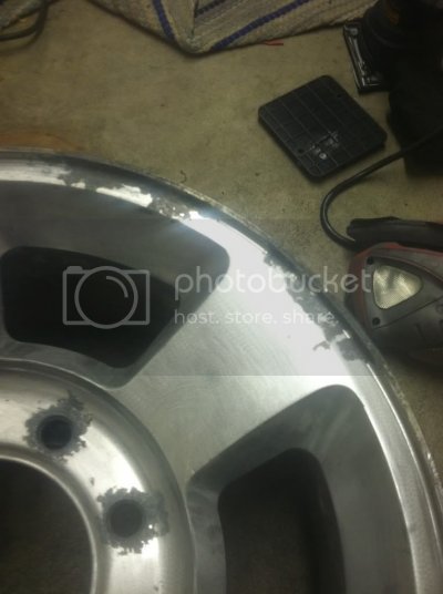

2500 come with optional clear coated polished aluminum wheels, the clear coat makes them really easy to clean but can be easily chipped by road debris, crimp-on wheel weights, lug nuts, etc.. Exposing the bare aluminum allows the aluminum to oxidize and pit (steel wheel weights and lugnuts will especially promote oxidation) Oxidation will form under the clear coat once it starts and lifts the rest of the clear coat. The only way to remove it is to sand it out and repolish.

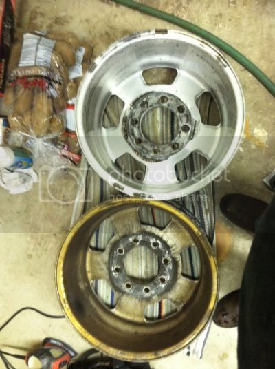

I started by cleaning the wheels. I used oven cleaner to clean 160K miles worth of gunk off the inside of the wheels. Do not use oven cleaner to clean aluminum unless it is coated or if you are planning on repolishing because it is very caustic and will leave a dull finish to bare aluminum

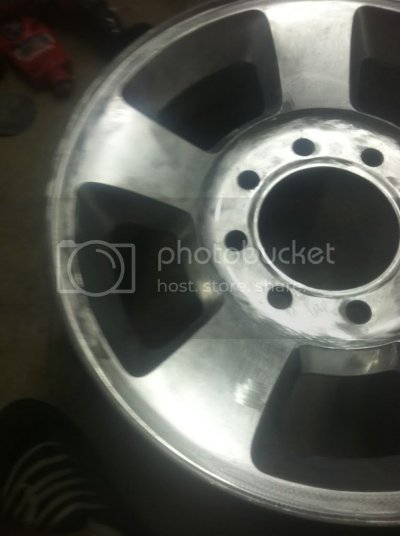

I start off using 500 grit on a palm sander to start sanding the wheels to cut through alot of the remaining clear coat and also makes it easier to see where there is still clear coat
Aluminum is a very soft metal so 500 grit will cut through most scratches, I only use 120/240/320 for removing oxidation like seen on the lip and around the lug nut holes

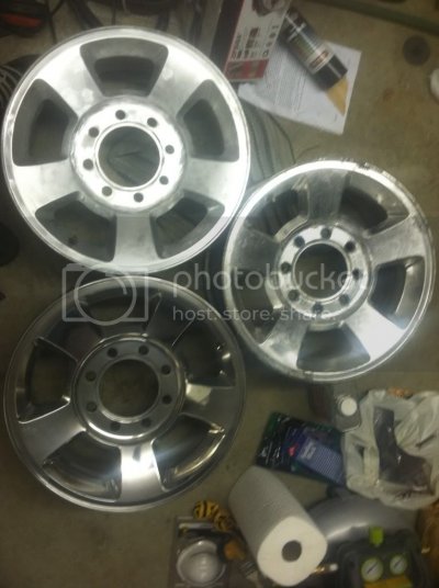

The top wheel has been sanded, the one to the right has had the clear coat removed and the bottom one has been repolished

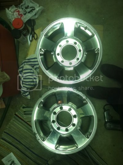

Finished product, the top wheel has had the oxidation removed and has been repolished the bottom wheel is a stock wheel that wasnt touched
