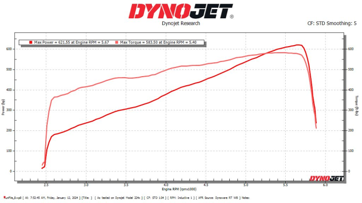

Amazing little 5.7
Jan 17, 2016
23,721
54,479
14 Sport
Barth Tuning
16h ·
We had a car surprise us with its power. That doesn’t happen very often here! This is the Dyno graph of a 2015 5.7 R/T! The car has a stock engine , ID1050 injectors , procharger d1sc , long tube headers and a aftermarket cam we installed. This is on 93 octane!! I didn’t rev it past the stock 5800rpm rev limiter because it will need a fuel system if I go any higher. You can see it was easily going to make power to 6500rpm. Next up, a fuel system and e85! This thing amazes us at ehe power it made on 93 octane !
