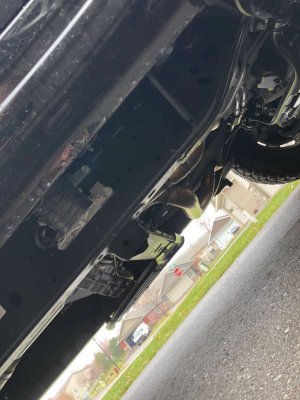

I have a drone around 1500rpm. It’s not exhaust, must be the anc. Anyway to just unplug the motors or whatever those things are under the doors instead of unplugging at amp?
I may be wrong, but I think those are dampers to offset vibration. Kind of like cab dampers, and not for sound.
Hmm, they have a plug in them. Do dampers have a plug for something?

^^. An you post a picture of exactly what it is that you are referring to please ?

Below each front door
