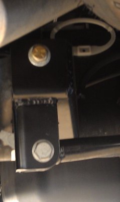

did you have any issues with the track bar relocating bracket?
No they must have fixed any issue with it not lining up cause mine fit perfectly when I put the weight back on the wheels.

thanks I really appreciate the help
maybe thats the whole trick....dont bolt it back up till full weight is on the wheels and its back on the ground

could you please take a pic of the trac bar with the relocating bracket installed
