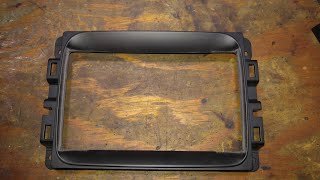

SECOND. The size of the bezel was just a HAIR wider than the METRA adapter bezel.

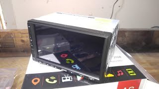

Here is the unit, the forward part of the bezel protrudes into the bezel adapter. The adapter has to be slightly modified to fit.
I took some sand paper and sanded the left and right insides of the bezel till the fit was nice. Really using a flat file would have been more effective. All you need to do is take a small mount of the back edge of the left and right side of the bezel and it fits perfectly.
Once the bezel is seated then you can use the supplied screws to bolt the side brackets on.

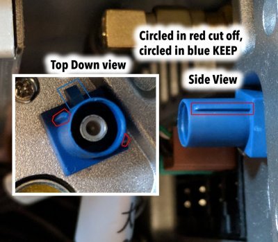

The unit comes with it's own GPS antenna but I wanted to use the OEM one since it was already installed.
I'm going to borrow this picture from the thread concerning installing the T-Syle 10.4" LCD unit posted by MDIFILIPPO. The connector is the same and the same modification needs to be made.
Cut off the alignment tabs with a razor knife. They kind of "shave off" that way so you want a smooth finish.
This way the OEM satellite antenna connector will snap right on.

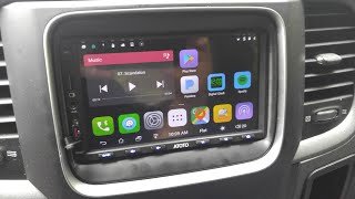

The unit looks GREAT installed.
Using the wiring kit and and accessories outline your install should go just as smoothly.
