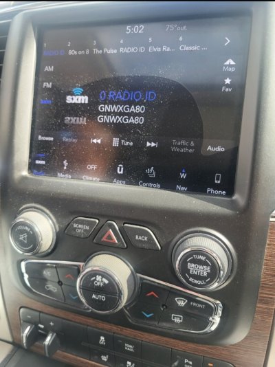

Thank you so much to everyone who replied! I will read all the replies more thiroughly when I get back this evening. As requested, here is a picture of my screenView attachment 566436
Ah yes, super-duper delaminated. UNfortunately there is also going to be a mess of LOCA (glue) on the bottom of that radio with that much delamination that will need to get cleaned too. It's not hard but is a pain...

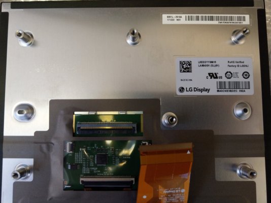

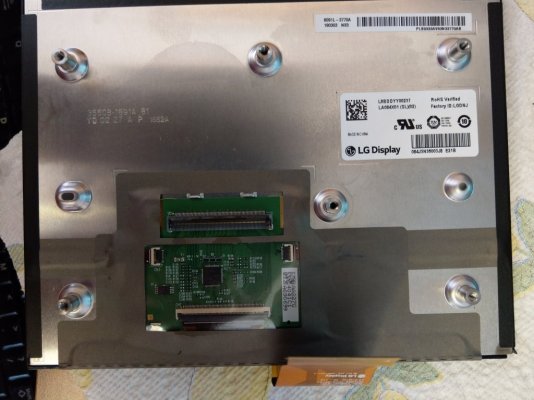

To be clear, the SL03 revision is the one that is post delamination fix so that one is supposed to be free of future delamination issues. LA084X01 (SL01)/(SL02/(SL03) are LG part numbers so their shouldn't be any "cheap" screens if it's the genuine LG part. I was unaware that there are third part manufacturers of these screens (only sellers) but from the listing pictured it looks like clones of these screens are now a thing. For reference, the manufacturing mark on the back of the screen should look like this if manufactured by LG.
View attachment 566426View attachment 566428
Believe it or not, but the one I got in looks exactly the same as the one you posted. I was surprised to see that it showed that the display was LG (along with the ribbon cable).
SL03s are post-fix, but they are much more difficult to find than the SL02. Knock on wood, no issues with this one thus far.

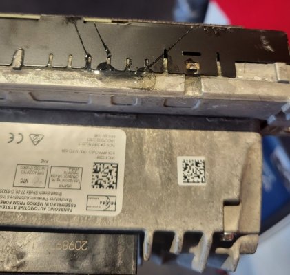

@RamDiver Unfortunately, the system or screen is too far gone for that to work. I did try but it only kicks on the heating system. The screen was beginning to delaminate when I purchased the vehicle a couple years ago, but I didn't know what it was. It just looked like someone took the front screen off and put it on backward without removing the protective plastic sheeting. The navigation is set to a different state (PA and I'm in OH). I was able to do that trick (pressing the 3 buttons simultaneously) when I first got the truck but it wouldn't let me actually DO anything--it required a dealership. Nothing was happening at that time with the radio--it just looked odd. It was maybe a year or more after that that I first read about "delaminating" screens. And it's only the past 6 months or so that it really went off the rails.
If the glue leaked out bad enough, it can gum up all of the buttons at the bottom of the console. I had to replace the entire switch panel because my heated seats and exhaust brake were literally glued in place and the glue was oozing through the gaps between the buttons. You may not be experiencing that problem but while you have it out, wouldn't hurt to check the back and clean them off if necessary.

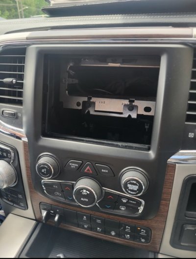

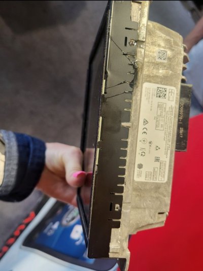

Thank you to everyone who replied. While I still haven't heard from the dealership (they ordered a radio around 6 weeks ago that they said, at the time, should be in in 2-3 days ), I went to a very reputable audio place a few days ago and should have a new radio in a couple weeks.
They removed the nuisance mess so I'm posting a couple pics for anyone who might search this thread in the future. Compared to the spazzy screen and constant AC vs heat flipping out, I'm happier with the hole in my dash at the moment, lol! The other two pics show the glue oozing out the bottom. 1000023105.jpg

Just so you are aware. Even with a delaminating screen that radio is still worth several hundred dollars. I'd put it up for sale in the forum to recoup some of your costs. At the right price, it will fly off the shelf...
