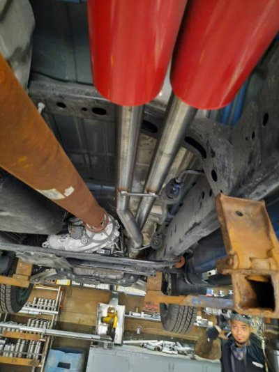

since you can weld and are going for sound definitely go for a true dual with crossover. all the pipe and the crossover itself helps absorb some of the nasty tones and you can put on twice the mufflers if you wish!
I have stock manifolds, 2.5 dual from before the y pipe (now x pipe) into 2 single chamber super 10 style mufflers to the stock rear duals with resonators
sounds absolutely amazing, head filling bass at cold idle if your standing behind it at start up
calms down alot to a perfect muscle car idle when warm
has the perfect old school hemi rumble when cruising through town at 2500- 3500 rpms. I use the gear+/- all the time so never hear mds and keep it at the rpms I desire
I consider it quiet in cab but when you get in a tunnel or tight city streets you can really appreciate the resonance :party36:
