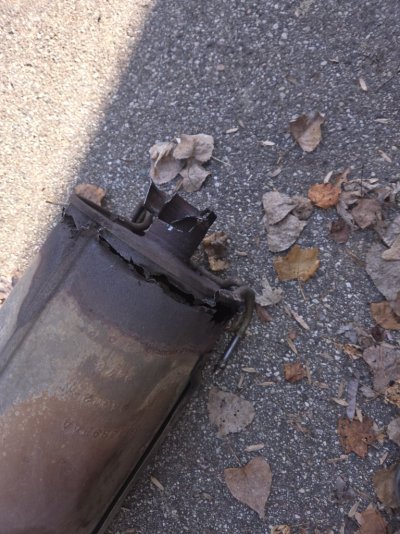

But my advice would be to crawl under there and give the exhaust a thorough inspection...this is what caused my exhaust to drone, and it's only a year older then yours
