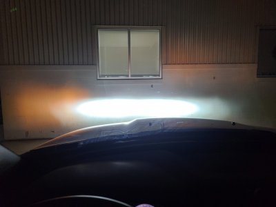

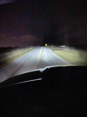

Figured I'd post some pics from this evening. No idea what the distances are, exposure is turned down a bit to try and give a real world view of the headlight brightness. Also, the parking is on a slight incline, so the lights are higher than where they would normally be.
First, close up with no fogs. Yes, this is going to be extremely bright because I'm literally about 5 feet from the wall. The orange/amber light is from my turn signals. 20210128_223529.jpg
Next is the same shot, but with high beams on. There is a lot more glare here, and honestly, I never noticed it before. But, these are high beams. Also, as I said before, I believe the highs are aimed a little too low and they appear to be hitting in the same spot as the low beams. There is a good bit of bleed off above the lights, but keep in mind I'm parked in front of a white wall that is going to reflect light back towards the truck and off the chrome grille and back towards the wall.
Next up, is a further away shot. I tried to take every picture with the exposure set so that the camera sees what I see. Cameras tend to make things brighter than what they really are. So, keep in mind this next picture should actually be a little bit brighter. 20210128_223654.jpg
All pictures are with the headlights only, no fog lights.
As you can see, the patterns are pretty even, nice hot spots, a nice short fade above the hot spot, and the sides taper off nicely. Is it a sharp, crisp cutoff that you'd see in a projector, absolutely not. Personally, I don't like the sharp contrast of a projector. I'd like to see someone with halogen bulbs try to recreate the same images I posted for comparison. I'd do it myself, but its cold and I really don't feel like pulling my grille off 2 more times. I've already got a few clips that are getting loose and need replaced.

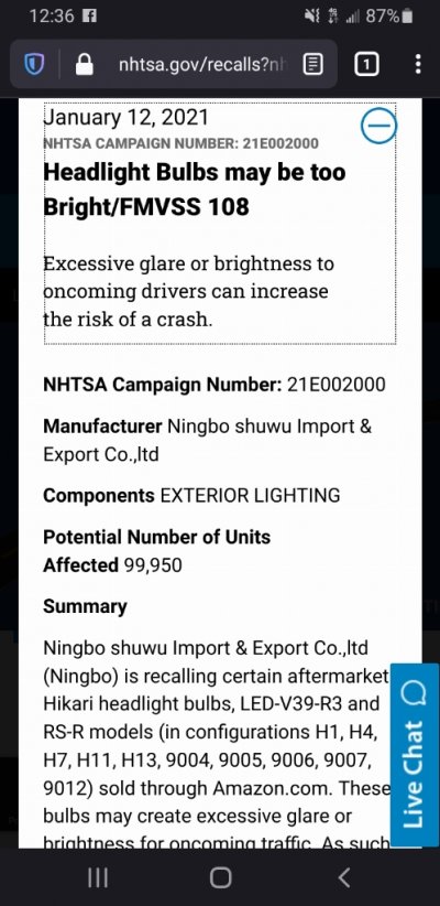

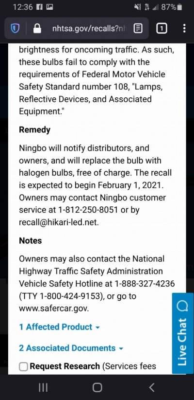

Just a heads up for the folks that used the Hikari Ultras (& likely other high output LED bulbs soon). There's now an NHTSA recall campaign forcing Hikari to send out halogen replacements. Not that anyone would.
(Probably due to people installing them in Standard halogen Reflector housings).

Yup, I put in Diode Dynamics LEDs about 18 months ago and got a similar letter a couple of months ago. I just ignored it but did notice that on their web site they no longer show LEDs for the low and high beams. I did notice however that my LEDs are no worse than the stock ones that they put in new cars and trucks nowadays....so WTF..:emotions33:

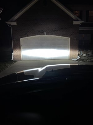

So, I finally quit flip-flopping on what I was going to, and settled on a path forward:
  • I bought Hikari Ultra LED's for both highs and lows. Plan was to install them in the stock reflector housing to see if, on my specific truck, they would work without programming and what the light pattern looked like.
  • I was ok continuing to not have DRL's, and was hopeful that I could get them adjusted properly to keep from blinding oncoming traffic.
  • Good news: They worked with no programming, totally plug and play in a 2019 1500 classic.
  • Bad news: They threw light EVERYWHERE. There was really no discernible hotspot on the garage door from 25 ft. and nothing even approaching a cutoff. Went for a drive following my wife in her Buick Enclave. Blinded her from behind and REALLY blinded her head-on.
So, phase 2 of the plan, if LED's in reflector housings was as bad as others warned me it would be, was to order the ModifyStreet projector housings and install the Hikari's. UNFORTUNATELY, I just realized the second piece of bad news with the Hikari's: The stock housings use H11 lows and 9005 Highs. The ModifyStreet housings use H7's in both.
So, I've revised phase 2 of the plan:
  • I'm going to return the Hikari's and replace them with 2 sets of H7's. I was ok with the color, was very happy they worked out of the box with no programming, and think I would be happy with them if I could focus, align, and adjust them properly. Hopefully the projector housings will help with that.
  • I'm going to order the ModifyStreet projector housings on eBay.
  • I'm going to rob a bank and sell a kidney on the black market to pay for it all. I wish none of this was needed, but the stock halogens were just so pathetic...

Yeah, quads. Not sure what the difference is, but I didn’t fee like it could be overcome by adjusting or aiming.
The attached pics don’t look as bad as I remember it being.
I drove a round a little and never got flashed either, but I should have been. It was pretty horrific meeting my truck head on.
I took the LED’s back out today and have the stock halogens back in. I’ll order the projector housings in a bit and some H7 LED’s. Now I’m not sure if I want to stick with the Hikari’s or try the Fahren bulbs. Decisions...
