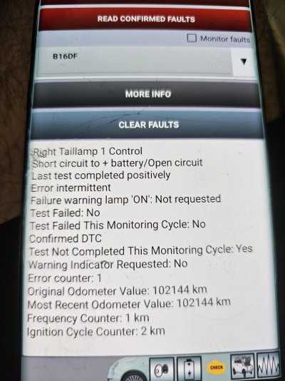

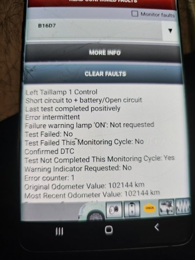

Hey all ... Have a 2014 ram 1500 big horn installed leds all over and used
AlphaOBD to change everything too led .but im getting parking light out but only when lights are on and i hit the brakes the tail lights are​
OeMassive https://www.ebay.com/itm/176154733151 i contacted them and they said i need a resistor installed even though it has one . all lights work no flicker none cutting out just that parking light warning on dash
so my question is what resistors should i get or should i try too get them too send me some new ones that come with there lights . or send em back and get different ones
also 2 small leds in the side stay on for like 20 minutes after i turn truck off

anyone know what resistors too buy and how too wire them in ?
