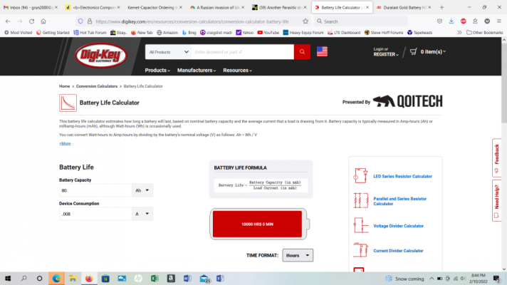

According to this calculator, at .008A draw, your battery (assuming GP 94R, 80AH) would go 10,000 hrs ...about 1yr and 1 month till dead. Unless I'm reading things wrong..

Thanks for that info @Jeepwalker . I’ll keep that handy.
