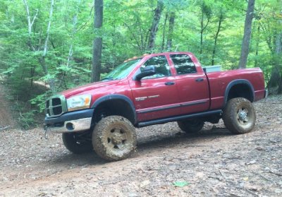

2006 with 3" rancho suspension lift with rancho shocks and 37" tires.
