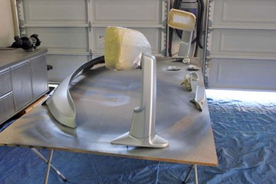

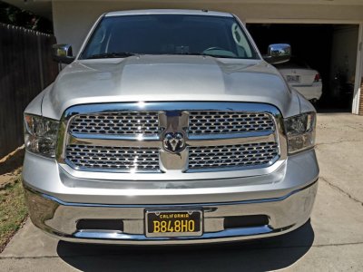

I painted mine. Actually a shop painted it for me, charged me $250 for the job. I pulled it off and took it to them, then reinstalled it myself.
The online configure app now shows the 2017s as coming with it painted body color.
attachment.php

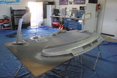

Plastic. Nothing to it. Then - in 3 months - if falls apart.
Plastic is tricky to paint. I've painted a lot of thing and trust me.. you'll want to do the following:
Wash it really good with dish soap and a gray 3M Scotch pad (body shop supply)
Spray it down and wipe with a mold release/wax remover spray and wipe with a red 3M Scotch pad.
Then use a high build primer (NOT ETCHING) with very light coats with about 10 minutes between coats. SEM makes a great primer in a spray bomb. Once you have about 3-4 coats - wet sand with 400 grit ...
Then you're ready to paint.
If you've done it before which I am sure you haven't - you just got the the easier part..
Paint.. But don't use rattle cans for this part! :)
Good luck doing it yourself. It's a learning process for sure.
PLASTIC PREP
GRAY HIGH BUILD PRIMER
6"x9" FINE GRADE SCUFF PADS 1 PKG OF 20 PREMIUM PADS
