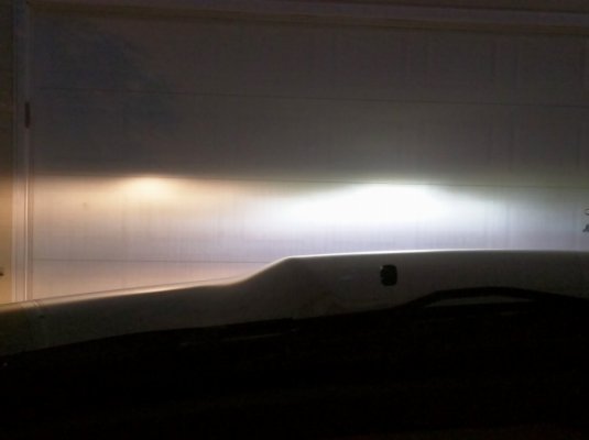

Nope. I'm running PNP's, any quad housing, and minimal glare.
there is definitely a little bit clearer but not much. It actually has about the same amount as my wife's stock HID reflectors on her Nissan.

I've personally seen this guys lights. Not bad at all. Quads handle HID rather well. Not quite as nice as my FX-R retro but much more inexpensive.

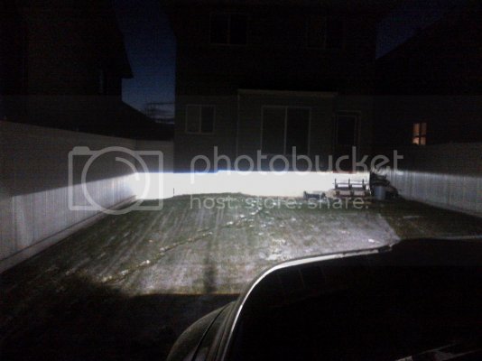

Comparison photo's of all three set ups:
Stock Quad low beam only, 40' throw distance
13+ OEM Projector low beam with HID (35w/5000k) drop in kit for $150
The New FX-R's are amazing, brighter more even beam spread,
wider pattern (even though this pic does not show width well) and a sharper cut-off
even when the sky is still blue just before sundown it lights **** the fk up Big time
still a 35w/5000k bulb, but a D2S instead of 9012

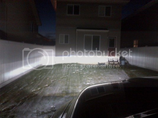

After dialing the aim down a little later on, a little darker out
with 35w/5000k fog HID's (for only when there's no traffic around) ($150)

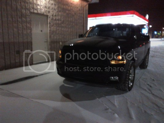

If you decide to splurge the extra for the FX-R's
you may as well pay a little extra for paint/tint to murderer them out
and add a halo kit or demon eyes
(my blackout paint/tint and amber demon eyes added $130)
Park light mode ... with Amber Demon Eyes
Jeremy also hooked me up with 13+ LED Tail light adapters
and I'm running OEM LED Tinted tails now too...Bright enough to cut through two coats of VHT.
Never been flashed unless I left my fogs on by mistake
