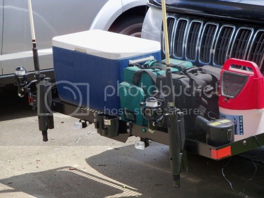

I built me a little deal for surf fishin' or fishing the sand bars on the river for catfish. Well I started with one of them chinese made "hitch/haul" clones I picked up from a truck accessory guy who sets up shop at my local flea market since the $39.95 was cheaper than I could buy steel & a hitch for to build my own. Then I just welded some 1" square supports for rod holders, mounted some lights & a 12v outlet for bait aerators, etc. I have this thing posted in the outdoor section as well.
Anyways, I want to put a couple lights on this thing so it don't get hit at night. it does stick out a good 3' or so whether I use it on the front/rear of my Jeep or rear of the truck. Leaving the 55w lights on obviously isn't an option.
So I'm thinking about a couple of those like 1' long amber flexible LED deals you see all over ebay anymore. Could simply wire them to a 4 pin and run them off my trailer lights when on the back of the vehicle. Have running lights & maybe even turn signals.
Here is what I'm talking about putting them on (I know it's not a pic of it on my Ram, sorry):

I ended up just getting a set of amber LED trailer lights, dual mode (running & turn signal) like George suggested. But I found them a good bit cheaper on ebay than etrailer had them for. Actually bought the pair for what etrailer wanted for one.
I have them, but I haven't mounted them yet. Took the rig out to the intercoastal for Redifish fishin' and the trail back to where I went was real muddy and had some pretty deep ruts. So the rig (and my Jeep) are covered in salty, briney, sandy mud. Got to get them both washed today and then mount up my lights...
