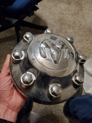

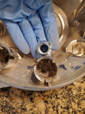

Appreciate any help. Anyone have this wheel and center cap? I can't find which lug nuts will allow the center cap to snap on. I bought these wheels with caps but I don't have the nuts! I was told they're from a 2018 2500. I've got the nuts from my other wheels on there currently but the center caps don't clip on.
I was going to get these from Amazon but some reviewers specifically said they didn't fit their center caps.
Any advice is appreciated!

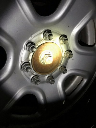

I have them caps.
Stand by and ill get ya a pic in a few min

Thanks, U&A! That was a super fast reply. Thanks for ungrasping your Ram to snap a shot.
Those look just like all the open-ended acorn lug nuts I saw on Amazon. I'll just order some and give 'em a go.

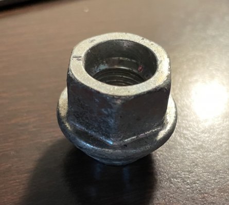

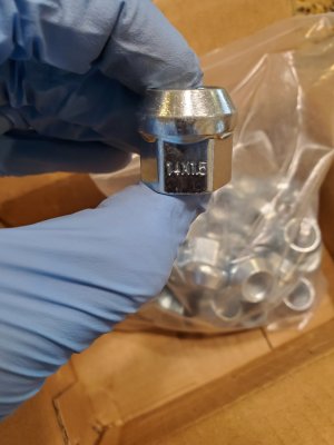

So I got these off Amazon.
16084080208112436452209159267548.jpg 20201219_115954.jpg 20201219_115918.jpg
The OD of the flared part of the nut is too small to be grasped by the retaining flange of the center cap! Looks like the nut OD is 22mm but I need something like 28-29mm to be held by the flanges.
Still looking...

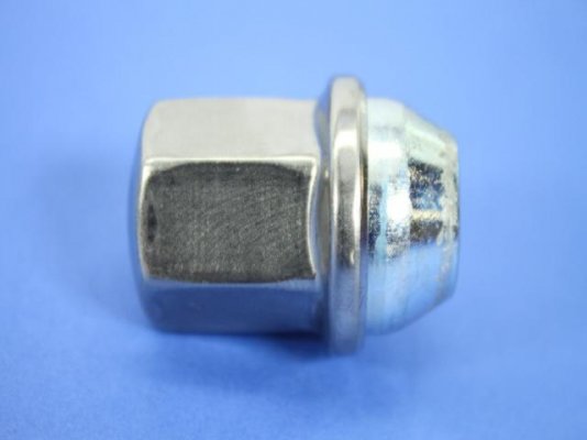

Here is an OEM lug nut #6509422AA for almost $10 each! Not sure if it's the right one but the flange seems larger.

@Darron - I found the lug nuts:
The wide part of the cone measures approximately 1-⅛" (diameter).
Let me know if that looks like what you need, and if so, PM your address, etc. and I'll package them up to calculate shipping.

Old thread but I had the same issue and this thread popped up on my Google search.
I found Dorman 611-979 M14-1.50 22mm hex 26mm length gave me the correct width for the clips on the wheel cap at about 1 and 1/8 in wide. My wheel cap had these numbers on the back: O4726279AA, 1XF55TRMAA, 45043.
