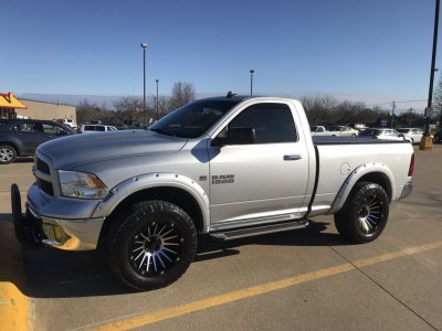

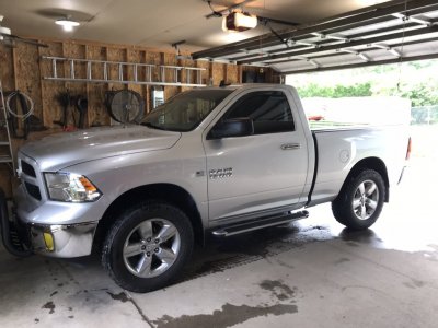

I ran 295-60R20 G2's on my stock OEM chrome rims and now I have them on my aftermarket rims.... I'm running 5100's set @ 2.8 and 5100 rear shocks.
