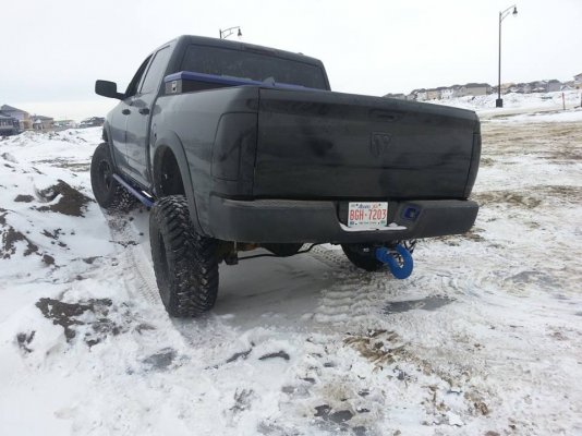

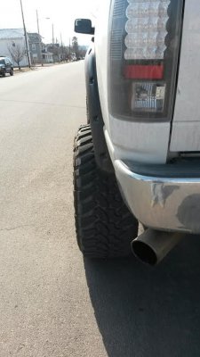

U say ur offset is -12 right so if I run a 38x13x20 with-12 offset I shouldnt have any problem with it rubbing or anything should I.... im jus cautious cuz idk alot about tire sizes and offset crap.,..cuz a 38x 13 is basically a 13.5 anyways someone was tellin me
lilwayne
lilwayne
Feb 16, 2014
43
22
thts how bad they stick out now with a 38x15.5 and 20x12rim with around -44 offset
[/ATTACH]
