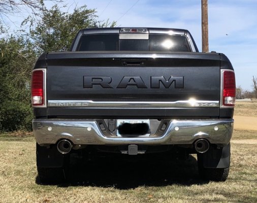

I have a Carven Progressive and it’s plenty loud for me. I thought the Competitor would be too much. Love the sound of the Progressive tho. I have the Carven 5 inch tips too. f0781374ad0d7b9121fdb1e4d241ab92.jpg

When you installed the carven exhaust, did you have to realign the exhaust tips? Saw one video on Youtube by American Truck, and his exhaust tips were off big time..

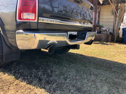

Not really. The driver side pipe kinda goes where it goes automatically because it has two hangers. This pipe has a second hanger in the center by the spare whereas the passenger side pipe just has the one hanger near the end where the tip goes. The tips- even the Carven tips, have a flared end that clamps on to the rounded end of the pipes so as long as the pipes are pointed straight in the general area, you can clamp the tips down in virtually any position.
The video you saw, they probably just didn’t put any effort in at all getting the tips straight.
Thus is mine, it looks like the passenger side tip is a little high but I think that’s just the camera angle because they really did come out straight.

Okay, I was wondering I think the guy didn't have the carven tips it was just stock tips, but truck looks sharp with those tips!
