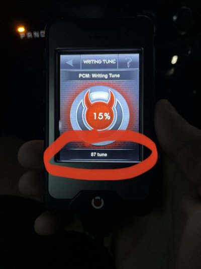

I have the same thing and I have NO complaints or problems. I've had it for about 20,000 miles now!

Don't leave me hanging, what are you guys using to tune (device or software) and where did you get the 87 tune?
I got the Diablo Sport tune through Hemifever tuner. I'm sure you can google him, that was how I found him. It's not cheap and I didn't buy it for the 87 tune at the time but he gave me the 87 and 93 tune for one price. It may not be worth the price to you but at $15 to $20 a tank difference it may not take long to pay for it if the fuel prices don't change. I figure we have 2 more years of it at least. I forgot to add that if your truck is newer than 2014 you have to get another PCM that is unlocked. That may change your mind. Wouldn't hurt to contact him to find out for sure.
