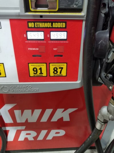

87 octane? Haven't seen any up here except for the Cenex in Hayward.
I fill my 12 gallon gas caddy and use for all my Briggs engines. Need 91 nobody for the 2 strokers per OEM requirement.
Down south in Whitewater...
