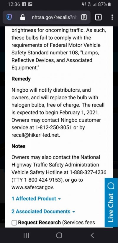

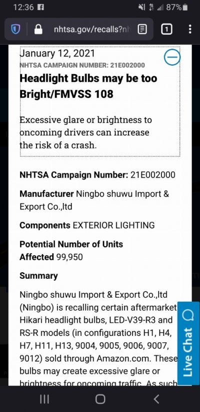

Just a heads up for the folks that used the Hikari Ultras (& likely other high output LED bulbs soon). There's now an NHTSA recall campaign forcing Hikari to send out halogen replacements. Not that anyone would.
(Probably due to people installing them in Standard halogen Reflector housings).

Amazon sent me an email about it (twice, because I bought 2 sets of Hikaris)
Like its Hikari's fault people use them wrong and/or dont know how to align them correctly!
Yet I drive around every night and end up blinded by every idiot that puts blue LEDs into their stock headlights (of any vehicle, not just trucks)
Huh haven't got one from Amazon/Hikari yet. Did get one from Amazon/JDM astar for the same thing
I have like five messages regarding this from Amazon in my inbox! Too much light, what's that mean?
