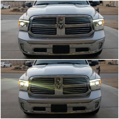

Hi everyone!
I want to give a big thanks to @1500ram12 @big daddys house @Jimmy07 and others up front.
Got rid of my 2018 1500 for a leftover 19 Laramie 1500 5th gen so I didn't think I'd be going down the ModifyStreet headlight route but ...
My parents picked up a used 2014 1500 CC Lonestar and their first complaint was the quad headlights (it has almost everything else except heated/ cooled seats). So I mentioned the ModifyStreet (G1 style) headlights and some Hikari Ultras H7 since everything was on sale the other day on Amazon (vs the much worse ebay lights my step dad was looking at).
Everything came in yesterday and we installed today. I'm was hoping they wouldn't have any issues once AlfaOBD changes are made, ie my 2018 with factory projectors only needed the HID setting with Hikari Ultra bulbs. (I'm under the impression that 14 trucks are a bit sensitive to some of the headlight changes).
PARTS USED
They got this Alpharex/ModifyStreet version without the lower DRL/Switchback (Same as the G1's ) ...
$280 - Modifystreet Chrome For 09-18 Ram 1500/10-18 Ram 2500/3500 DRL/Signal LED Dual Projector Headlights
ASIN: B07VJJ55DD.
$54 x 2 sets (High & Low beam) - HIKARI Ultra H7 LED Bulbs Conversion Kit -, Low/High Prime LED 12000lm 6500K Cool White Foglight
ASIN: B07VSF45ZM.
ALFAOBD (& OBDLink MX BT) PROGRAMMING NOTES
2014 Ram 1500 Lonestar with factory quads. Settings that worked....
VEHICLE CONFIG 3:
>> High Intensity Discharge Headlamps = YES
CBC FEATURES:
>> LED Front Turn Lamps Present = YES
>> LED Front Park/Marker Lamps Present = YES
DRL relay box = Fuse F66
(May wire this up to the factory DRL BCM feed later)
----- Future LED Foglight bulb swap -----
CBC FEATURES:
>> LED Front Fog Lamps Present = (YES)
DIDN'T NEED the following for bulb out messages ... YET
(G2 switchback versions seem to have the turn signal/bulb out issues requiring extra Door Ajar/bulb monitoring changes)
CBC CONFIG I/O USAGE:
>> Front Driver Door Ajar Switch Signal Usage = (DISABLE)
>> Front Pass. Door Ajar Switch Signal Usage = (DISABLE)
>> Door Ajar Switch Signal Rear Left Usage = (DISABLE)
>> Door Ajar Switch Signal Rear Right Usage = (DISABLE)
Not too shabby for $390.
Parents are very pleased with the upgrade!

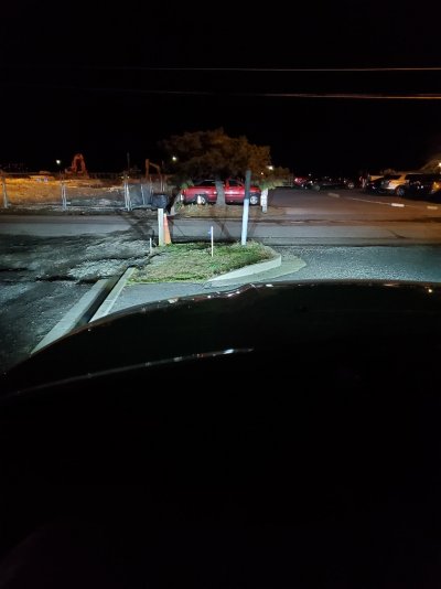

Well boys and girls I've found a good bulb for these lights. I drove my Mazda cx5 with leds and my pops tacoma with leds.
Mine blew them out of the water
Alpharex g1s
Aukee 20000lm h7 in my lows 6000k
Hakira ultras in my highs 6500
Pics below of low beam. Not a huge fan of the hakiras.... esp the 6500 color too blue.
That being said the biggest advice I can give is clock each bulb on their own to get the brightest output before putting them in fully.

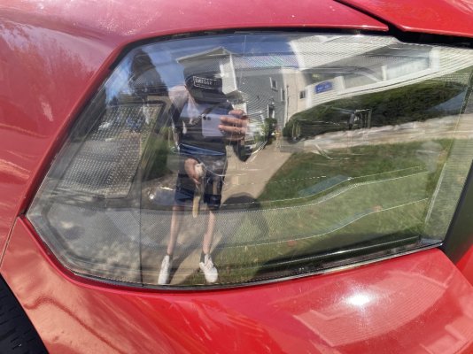

Hey guys
Long time lurker of the forum. Just got the base model Alpharex 2019 style headlights and would like to open them up to tint the side marker. Is there any kind of tutorial that exists to open these specific headlights? I previously opened the factory duals so I have some experience. The thing I’m not sure of is what needs to come out of the headlights before they go in the oven.

They open the same way. A little easier because they don't use permaseal like oem headlights. Just remove the bulbs and back covers

Normally I open lights from the flat end that is vertical (inside part of housing) but with these AlphaRex lights I found it was easier to open them from the end that is slanted (outer part of the housing, that meets the fender on the vehicle). For some reason once you get a corner popped and grab the lens, it’s easier doing it from the opposite end. I have a video on opening them, I just need to finish filming a comparison video of them vs some other retrofits I have then I can post the video, it shows exactly how to open the AlphaRex lights. Not sure when I’ll get to film the comparison video though as it’s 30 degrees or colder every day now.

Thanks for the tips
If you don’t want to tint them, I sell smoked and clear corners for these exact lights.
Wow those look great! I’ll try tinting them first and if I’m not happy I’ll hit you up.
