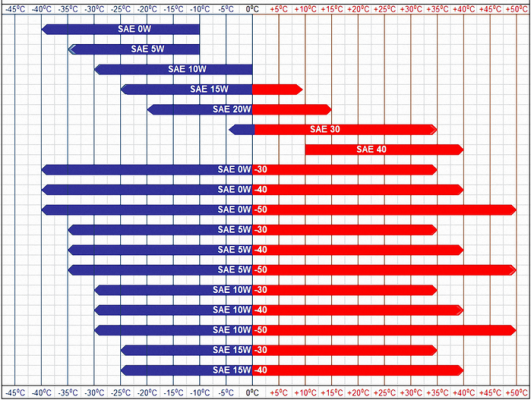

The first number is winter rating, the second number is weight, the weights are srandard cSt or operating temps.

As the chart shows, it all depends on your climate.
In the summer time (no temps below @55 degrees F, even at night), I usually run 10W30 and actually get @10% better mileage vs. the spec 5w-20 (both grades being mineral oils).
The thing that chart doesn't explain is that the farther apart those 2 numbers for dual viscosity oils are, the worse that oil will perform at either end of the spectrum. 10w30 will not perform as well as straight 30 at high temps. Likewise 0-30 will not perform as well as 10-30 at higher temps.
Synthetics will always perform better and last longer than mineral types at high temps, but the same rules regarding dual viscosities apply to them as well. If it doesn't get cold where you are, an ultra low w-number really isn't doing anything for you but compromising the performance of the oil on the high-temp end.
