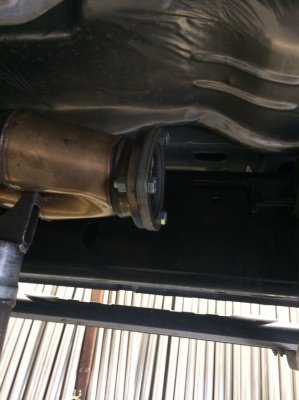

I never liked that setup so I had this done.any good exhaust shop can do it. Makes taking it apart much easier too. image.jpg
