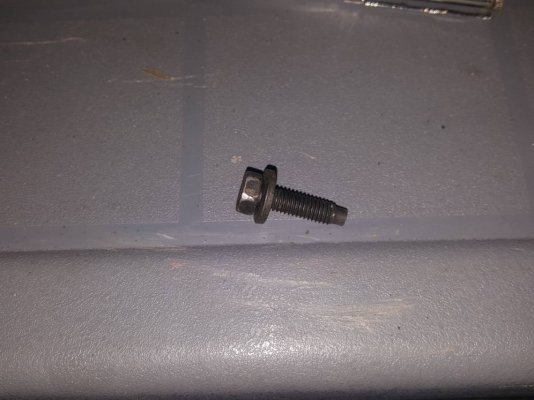

3rd this bolt
yeah that's the bolt for the lower bracket of the dipstick tube. This took my afternoon to get off. Lifted the engine and was able to get it out, but what a PITA.

3rd this bolt

You aren't the only one who lifted the engine off the drivers mount to get that bolt out,lol.I swore that little ******* was long enough to hold the motor mount on,on the other side of the engine:roflsquared:

Also slide the dipstuck tube back in place before tightening up the header.If the header has some wiggle room,it usually makes it easier to get the tube back in. I shortened the bolt slightly,after finally getting it out.

Yup lol. I ended up going to a custom 29" Lokar dipstick,it made things a lot nicer .

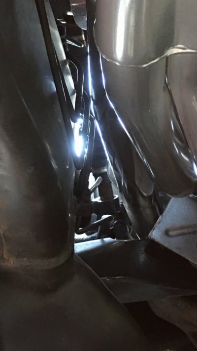

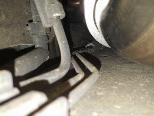

I put some ARH headers with cats on a couple weeks ago. Just a heads up make sure the Y pipe and headers are not to close the the brake lines that run down the frame. Mine were only about a quarter inch away and I ended up burning a hole in one of the lines the other day, even with cool tape on them. I tried to adjust the headers and Y pipe ever which way but that is just how mine lined up. Maybe I'm just unlucky as I have only heard of one other guy on hear with ARH headers that has had this problem, so maybe it will be a non issue for you. I just got done about an hour ago rerouting my brake lines to resolve the problem for good. Hears some links below of mine and the other guys with some pic's.
Hears some pics of mine that I posted in this trend.
http://www.ramforum.com/f44/arh_header_question-106634/
Hears another member on hear that had the same problem with some pics.
http://www.ramforum.com/f44/arh_headers-99875/index3.html#post1504509

Yeah mine doesn't look too bad.
Does your y pipe sit below the frame cross member? This is a low point that might be problematic for off-road d6d96a46a54025eab38d5b196abf1a2f.jpgb2074bd17a6a9bb9b9026464e2e0a4a4.jpg
Sent from my SM-N920W8 using Tapatalk
That's odd, your lines seem to be routed a little different then mine were from what I can tell in the 1st pic. I notice you have a 15, i wonder if they made some slight adjustments to brake line routing in the 16's.
Yea mine has about 2 inches of hang compared to the cross member so this could very well be an issue if you go off road a lot.

Mine brunet through the reflective shield, through the cool tap and in to one of the lines. I had mine wrapped but ended up taking it off because the wrap was making direct contact with the brake lines. I ended up borrowing a flare tool, bought some stainless steel line and rerouted them just to be done with it and for peace of mind.
Also I went out a few min ago and looked under the truck and there is diffidently a difference in the brake line routing between my truck and the OP's truck from what I can tell from the OP's pic. Ram must have made some changes to the brake routing on the 16's, it is minor changes but enough to be a problem when running these headers.

For the worse if you are planning to install these headers, I have no idea about other manufactures. If you look at the op's first pic you can see the two brake lines running along the upper part of the frame and then they angle down and go into the plastic brake line clip and then back to the rear wheels. That plastic clip is about 2 or 3 inches past where the y pipe turns toward the passengers side of the truck. With my truck it just runs straight along the lower part of the frame which puts the lines right behind a section of my Y pipe and where my header connects to the Y pipe instead of angling towards the top part of the frame like the op's which gave his plenty enough clearance.
If you look at the pic's in the trend I posted you can see my lines run on the lower part of the frame and has no angle in it to route the line to the upper part of the frame which would have probably given me no troubles at all.
