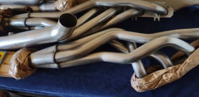

Well I fired up my truck this weekend and heard the loudest ticking noise. Obviously a broken exhaust manifold bolt. Only 41k miles on the truck too!
So I ordered some ARH long tubes and am going to document everything here.
Still need a few parts:
Going to contact Lokar to try and get a custom dipstick made.
I also ordered some remflex gaskets. Do I need to order ARP header bolts or does the ARH setup come with good hardware?
What kind of heat shielding should I get for the brake lines and any wires that are close by? I was thinking something like this stuff
Any tips, tricks or advise for installing these things? It has been about 10 years since I have installed a set of long tubes on a truck. Last one being my Dakota r/t and that SUCKED!!
