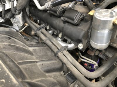

Back in the shop after a couple hundred miles to have the headers retorqued. Here's a few pics after I gave her a bath. Notice the hose clamps unattached on the right side (and the hoses held up by zipties)? Good thing I really inspected the engine bay post-install. The hoses were just sitting on the headers and melting. The shop said they would replace the clamps and the hose. Meanwhile, I have to drive around like this for a few days LOL.
