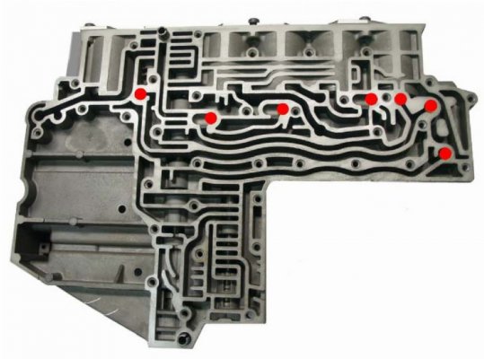

Did you use the valve body from the 45rfe? If so it could be the check valve locations. Also, do you know what color the solenoid pack was?
The first one below is the later model valve body, 2009-2010 plate stamped 52120004A.
2011-later plate stamped 52120004AB.

As far as shifting rule of an rfe there is one absolute, "If you are not sure what valve body you need for any RFE transmission just install a seven-ball separator plate with a white solenoid and you can’t be wrong." So even though the grey ones may have better or latest quality, the rule above can play in any rfe.
It weird because even though newer rfe's have more gears, they have less check ball locations, but they still follow the rule above about 7 check balls plus white solenoid plays in any rfe.
