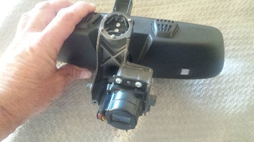

The Auto High Beam mirror has what looks like a small camera that detects oncoming traffic. This is a Auto Dim/Auto High Beam mirror. You can clearly see the lense.
