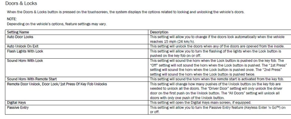

Your U Connect System has Doors/Lock screen under submenus. Go in there and enable. ADDED: Out of 2025 Manual. You can download and have on yer PC.

OP has high speed okie dokie 2025 Tungsten, gonna have the U Conn 5, 12" display, I posted the info from a 25 manual.

Thanks for the reply & yes this is where severl of the YT videos said the setting would be as well. I'm assuming that the software update removed the feature. as it's not there but the rest of these options are. (sorry for the bad photo quality)menu.jpg

The update moved that setting to the IPC and the dealer has to enable it for you.
Reference Star case S2508000003.
The same thing happened to my 2025 Limited when I received that update last Fall
Thanks for chiming in. IPC??? WHY would an option available by driver enabling be removed and put under IPC? WHY I do not allow RAM to flash my 2024 TSB issue, that is still outstanding. The last time they flashed my BCM, they "fixed" five issues, but caused "2" others, and they cannot go back and fix.
OP: Here is the STAR case from 5th Gen Forum addressing the Auto Lock feature: see pdf. Sounds like trip to dealer, and I would print the TSB and have in hand.
