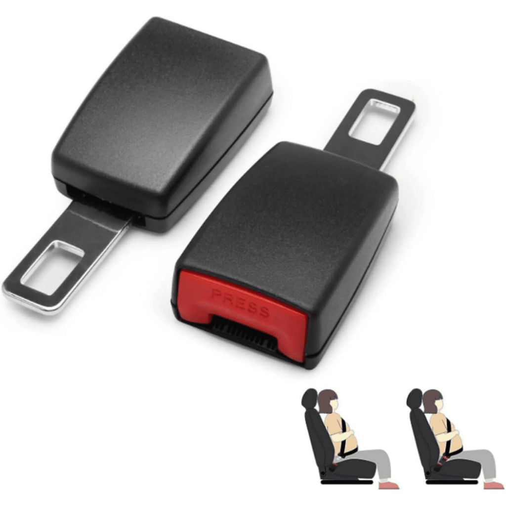

Is it posible to turn of the darn auto park gismo when I try to back up to my trailer, and leave my door open?
It's a bad habit to get into leaving a door open while your backing up, an innocent truck may get it's door damaged, mirror usage saves body panels.
Buy yourself a 3" seatbelt extension and leave it plugged into the driver's side, that will keep the truck from automatically going into park if a door is opened.

The seat belt being latched in works. You can also put a jumper wire in the seat belt sensor harness under the seat but you run the risk of forgetting to put your seatbelt on when driving.

Latch the seat belt behind you if it is only occasionally, or do like many of us and use a cheap extender. Easiest and cheapest fix. Can also be disabled with AlphaOBD.
10 bucks for two on Amazon

I had already purchased a seat-belt-extender for the Ram after having owned them for two other vehicles. They have several benefits, especially if you wear a Parka for a third of the year.
I also have a small flat bottle opener that plugs into the seatbelt socket. I used it with my Tundra for the passenger seat while travelling solo with a heavy cooler on the seat. The Tundra had a button to disable the passenger-side airbag, but not the seatbelt nag.

This what I have and use. Just keep in truck when I need, but do not normally back up looking out door, use mirrors and camera.
Now, backing up a lot with door open, that would be like in a field getting hay, than the clip is extremely useful of course.
Post #7: Extenders work, just leave plugged in 100% of time, I just plug in mine when specifically needed.
