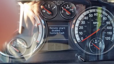

Auto Started , about 5 seconds it shuts off and displays:
Remote Start Disabled
System fault
2500 2010
Any ideas?

Here's the screenshot

if its factory take it to the dealer it might need a reflash.
Its factory. . Plus it starts and stops when it wants to now.. weird.

It was due to the check engine light AND a defective key fobik. The windows rolling down was a tip off that the key was bad.
Here's the details: click here
