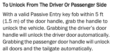

Fob works okay but pulling on drivers side door handle won’t unlock all doors. Passenger side handle unlock feature works normally.
Any suggestions as to the problem?

Is this not a setting in uconnect on the radio, lock/unlock all or just driver? The setting is there, and I know it is definitely for the fob but do believe it also is for the passive system. On my 2015 it did all the doors lock/unlock same on my 22 and all my other jeeps, Durango's and charger because I have them all set to all doors. The only "door" on the passive system that will only unlock just it is the liftgate/hatch and tailgate that will only unlock itself and not other doors.

IMHO, The fob is doing what it is supposed to do - a security measure. The driver can get in, in theory no one else. When you open with the fob from the passenger side you are admitting passengers. I'd leave it as is unless you live somewhere very safe.
