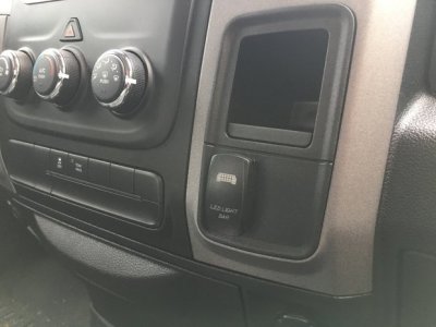

I tried a search but every thread I found has all the pictures lost due to Photobucket's new policy. I need to mount my switch for my LED bar but having a hard time trying to find a good location. I'd like to see how others have mounted their switches..... thanks!!! I attached a picture of the switch I want to use.

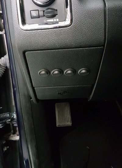

I have two similar switches mounted left of the steering wheel, on the blank dash panel under the headlight switch.

Like in the picture Juvenator93 posted above??? That's where I was thinking but I wasn't sure there would be enough room with that neutral release lever in behind that panel....

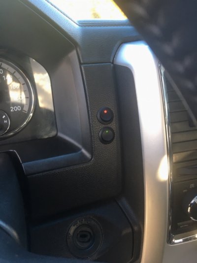

I mounted similar switches in my 3rd generation to the left of the steering column. The 4th gen is different but I believe there would be room to mount in the same location. The position would be similar to where I had the "red' switch mounted in my third gen. Picture attached.

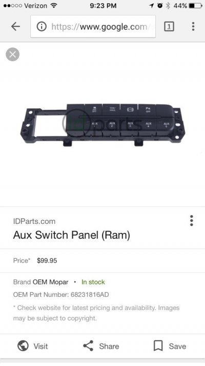

Here it is. Depends what you want to spend but for me it's worth $100 to not drill holes in a $30K truck. It's a ground switch, so you use it to trigger the ground side of relay.

The last guy said this was 09-12 only, and looking at my trucks my '17 1500 is different, my '16 & '17 5500s have the old switch. The 1500 does have a panel, just a different one. Do a little research and I'd surprised if there's not an oem option. I think these were like $70 with the pigtail from the dealer.
I said that was for 2009-2012's only because you posted a pic of the switch panel for 2009-2012's only...

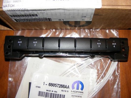

Ok so I want one of these switch panels I just have one question, and I will post a pic of what I have now. The switch panel I have in now has the hazards, limited slip button and tow/haul button If i take that out can I reorganize those button or the AUX buttons in the new panel? I hope this makes sense
