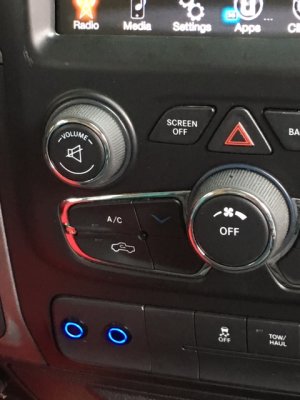

Until I get my switch pod to hook up all my other goodies, this will do for the lightbar. Switch snapped in there like it was made for it!

Can you give a quick overview of how you did this? Does the factory plug disassemble easily?
I have a similar looking switch operating Brandon's BW44-44 clutch lockup switch on my laramie with bench seating, would like to mount as close to 4x4 factory switches as possible. This is a very clean and simple solution

It has been awhile, but if I recall correctly, I unplugged a connection at the rear of the socket assembly, removed it completely, fed wires through it, connected them to the switch and then snapped the switch in. I removed the bezel and possibly the lower tray to get access to pop the assembly out.
It was a rediculously tight squeeze between stuffing the switch and wiring in the socket assembly, I almost had to consider cutting the end off the socket assembly to allow room for it all so it would fit. That probably would have been easier

That's what i assumed.
Ended up stuffing the switch through the steering console gap for now. Turned out my switch is too oval-shaped to work.
I know I have seen the same switch I have at pep boys over in their aftermarket section. It is a small kit that includes the wiring. I am sure they also just have switch over in the aisle with all the other switches. Probably just a few bucks, it's a cheap switch
