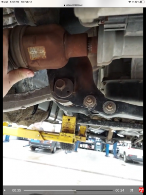

I posted this in another section and didn’t get any replies, how much axle play is acceptable? I got a horrible rattle I’m trying to track down linked to headers or this, I’m lost.

Mine is the same, I just checked for you.
But not as rusty - yet.
THAT being said, the next time that it is up on ramps, I am going to fill them full of grease with my needle fitting for the grease gun.

Holy **** that's way more then mine. I would put money on the splines being worn out

It rattles more than mine, but I don't know if there's that much more movement - it was hard to tell from laying outside of the tire :)
He could pump his full of grease and that should quiet it down some IF that is his rattle.

Yeah I just spent about 4K replacing both axles and the front differential on my truck and they wobbled just like that.....

SOB, what kind of noise was you getting? Looks like your axle clip fell out?
I had a rattle, and then no shelled out the splines. I believe the C clips broke and that was the cause of the failure.
