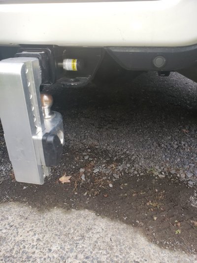

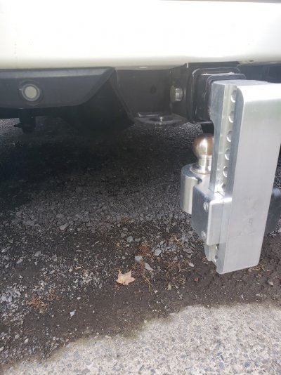

I know it’s not the same hitch but I leave my adjustable 6 inch drop WeighSafe hitch in all the time except for winter and it doesn’t interfere with my backup sensors.

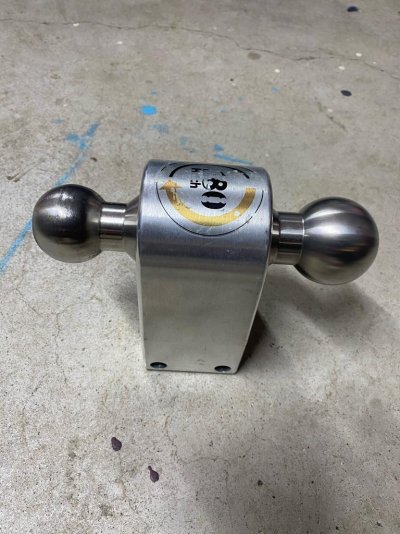

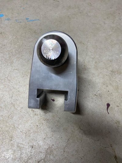

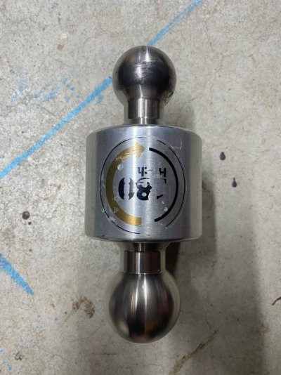

Are you looking to get one of these receiver hitches? I don’t mean to slightly reroute your thread but if you are and if you’re interested, you could save a little bit of money and just buy the drawbar and lock pin new, and I have a used 180° flip slider that has the 2 inch stainless steel ball on one end and a 2-5/16ths ball on the other end for a little bit cheaper than buying the complete set brand new.
I originally bought the 6 inch drop 180° hitch but since my halfton isn’t as tall in the back, and when I have the slider all the way down in the 6” drop position, I have a slight ground clearance issue because the other ball is on the bottom making it closer to the ground so I bought the other slider, the one that just uses one ball at a time because it has the scale built into it for measuring tongue weight but since I’ll never be hauling anything that heavy where tongue weight will be an issue, I just bought that other slider for increased ground clearance.
The bigger ball has never been used and the only trailer I pull is a little 10 foot utility trailer that hauls around my mower so that 12,500 pound hitch has never even been fully broke in. Lol.

If you were to buy all that I have that I’m selling brand new- the 180° slider, the stainless steel double-ended 2 inch and 2-5/16ths ball and the little pin that keeps the ball in the slider, will run you $135 bucks without tax and I’m currently trying to sell all of that above minus my double slider pin that secures the slider to the drawbar and the drawbar itself for a hundred bucks shipped. You’d still have to buy the draw bar new which depending on what size your receiver tube is and whether you want the 4”, 6”, 8” or 10” drop- if you got say, the 2.5 inch shank and say, the 6 inch drop drawbar, you’re looking at a hundred bucks for that and about 20 bucks for the new lock pin so, $220 total this way vs 260 bucks for a whole complete brand new complete 6 inch hitch kit for a 2.5 inch receiver without tax.
I plan to use one of them post office “if it fits, it ships” box to anywhere for a flat rate and that shipping cost is included. 0771fea8e721401ba336b3b937cdb3f5.jpg

Really? Hmm. I wonder if it’s because yours is steel and mine’s aluminum? Granted, here lately I keep my slider pretty low since my trailer in order to ride level needs the full six inches of drop but even when I’ve had the slider half way up the drawbar, my backup sensors don’t even detect it. Only when I have a trailer coupled is when I pretty much have to turn the rear park sense off.
