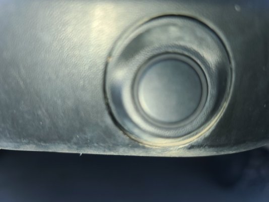

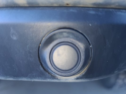

This is what they should look like. There are only 4 on my 2021 2500 rear bumper too.
Right side near plate
Far right
