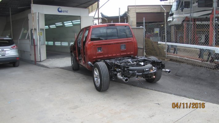

The OEM camera is attached to the tailgate handle
The are 2 wiring pigtails that run from the tailgate handle down through the tailgate
At the bottom of the tailgate there is a black plastic piece that both pigtails pass through
Hidden behind the license plate you will notice a connector, there may be 2 connectors.
These connectors are where you would disconnect the wiring if you want to remove the tailgate.
From that connection the wiring pigtail more or less follows a sub frame over to the Main frame & travels a short distance along to the Drivers side frame close to the drivers side rear tire, where the is another wiring connection.
I don't know why that connection is located there, unless if you wanted to remove sensitive parts if work was needed to be done on the Exhaust pipe on that side.
GTyankee
Nov 2, 2020
12,391
17,459
El Cajon Calif. 92021
3.0 ecodiesel
The wiring in these images was just wire tied in the most convenient way to allow my Ram to be be moved around as needed

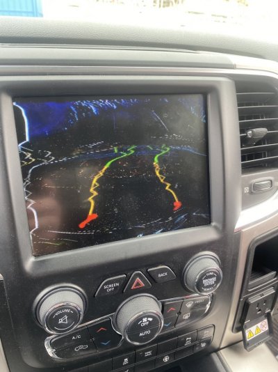

I just started getting this on my screen a few days ago. Connection issue?
