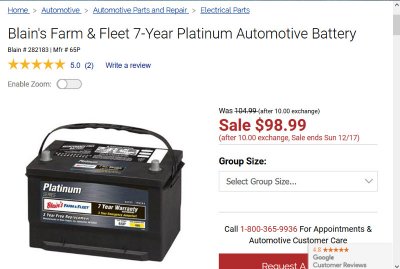

My buddy has had Optima batteries back when Gates owned them, last about 10-12 years and he said one of his had gone flat a bunch of times. I've got a handful of yellow-tops and they're in the 8 year range, still going strong. But then again, I've gotten 8-9 years out of regular flooded lead/acid batteries too and you can buy a really good one around here for 100 bucks ..and less even less for lower quality. (I don't know where you're coming up with $200). I'd be looking for a battery with 'thicker' plates, not thinner like some advertise. Thinner means less life. Are you using LED's in emergency lights?
Oh, it's not just Rams that run suspect on low batteries. I've had it happen on other makes even 10 years or more ago.
