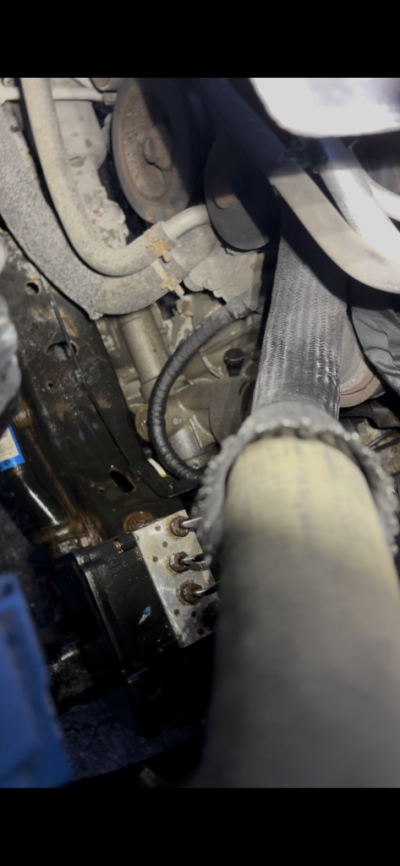

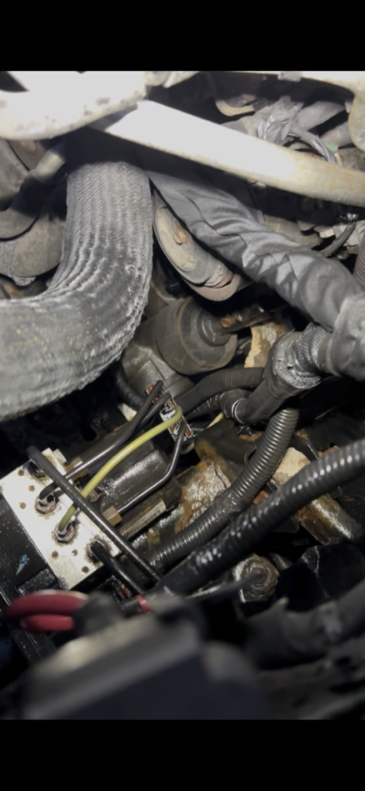

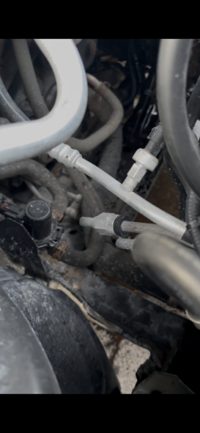

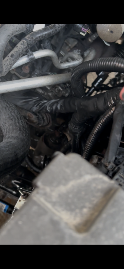

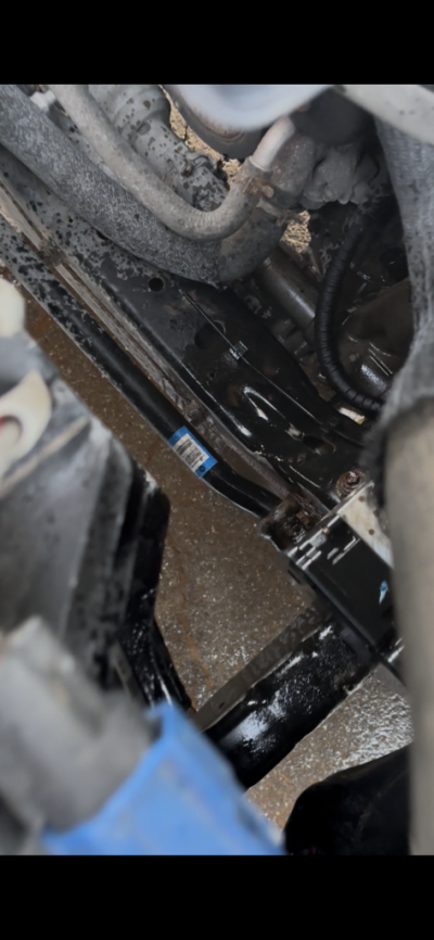

To keep it short, was driving my 18 1500 3.6 for around 20-30 mins. Stopped and placed it in park, noted my coolant temps were around 224. Truck idled for maybe 1 minute. Turned it off, went to the trunk, went back to the truck to grab something, then boom. Reddish brown fluid leaking everywhere like an explosion. I think it’s trans fluid because my coolant is green and my oil isn’t that. Leak looks like it came from underneath the battery on the low side of the car, problem is, everywhere on the drivers side in the engine bay is dripping so I can’t figure out the source of the burst leak. Any help on what just happened? I had no choice but to drive back for 8 minutes to a parking lot. Everything seemed fine and smooth. Coolant temps got at a high of 228. The whole drive felt smooth. Trans felt smooth too..
Can’t figure out what’s up.
I did pop a check engine light for my thermostat being under recommended temps. Cleared the code and drove for a little to see if anything would change and monitored my temps constantly with no light popping back up and temps not looking too crazy. Longer drives the truck got to 205 temps.
EDIT..
The first 4 photos attached are from the second I heard this leak spill..
The second 4 are from after driving it back from where this leak popped.
I had to drive 8 mins covering 1.5 miles.
Not sure about the coolant being green or the reason of. But checking the lid of the coolant, it had green residue of liquid on it. Unless that’s due to color change of over time, that’s the color I presume the coolant is. I am not sure why my colors are the way they are.. maybe I’m retarded, I usually keep that in the equation lol..
I am NOT well versed in the realm of the 3.6 1500. Nor am I well versed in the ram world or truck world for that matter.
Living in the barracks, the ability to work on this is limited. I’m looking for answers and knowledge as to why different things decide to **** the bed.
I had it towed. Took it to my mechanic. Waiting to see on his diagnosis. Always wanting to learn about why **** goes wrong though..
Maybe enough **** goes wrong I’ll know how to repair the whole damn thing.
EDIT 2
So update, after looking everywhere, the radiator actually cracked, causing the pressured coolant to blow everywhere. Was the left tank. Unfortunately I do not have the capability to repair this on my own, its taken to the shop to be fixed..
Nothing else is wrong with the truck besides a very very small crack/leak on the stupid plastic oil filter housing that will be replaced with aluminum at a later date..
Thanks for the help gents

You gotta figure out what that leak is/was. BEFORE it takes a giant sh*t on you.
Coolant should be purple, but it turns reddish once its heated. If you mix the wrong stuff, it turns ugly and can causr all numbers of bad stuff.
Pictures would help, you gotta find the source.

I did check what I could see surface level wise. My coolant is green. Opened the lid. Looks full and I’ve got coolant in the reservoir aswell. Not going to be driving it until this is for sure fixed. Trying to get an idea as to what’s going on

that v6 has that silly oil filter with a heat exchanger in it does it not, that would puke out oil or coolant out the rear of the motor, I can't tell anything from the pictures .
If it was trans fluid, I can't see you driving for a few miles without it going to hell .
I would think a steel transmission line to the cooler.
one other thing, a head gasket let a bunch of pressure into antifreeze, but that would be milk shake look in the tank/ground.
Reading the post again, I would be really checking out the water pump and the hoses.
