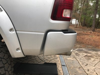

Anyway, picked the truck up and didn't realize they screwed up a few things. I don't drive it everyday, so when I got it back it was parked for a day or two. Then, I realized the rear bumper was not aligned correctly. The passenger side looked OK, but was real close to the body. The drivers side was all out of whack. The side angle of the bumper didn't match the body lines on the side of the truck and it was way further away from the side of the truck....a couple fingers could fit between the bumper and the body, where on the passenger side, I couldn't get a finger in there. The place that did the install is about an hour away, so I called them and told them about the rear bumper, but said it would be easier for me to just fix it myself. Spent an hour or so removing the spare tire, loosening the bumper bolts and trying to get it aligned correctly. Ended up adding 4 washers between the new brackets and the bumper to get it to look pretty good....still slightly more space on the drivers side....but not noticeable. When I dropped the truck off for the work, I asked them to paint any of the rear bumper parts that were being cut or ground down. Their answer was "you don't even need to ask...we always do that". Well, guess they don't "always" do it. They never painted anything and now I have shiny ground down metal that needs to be painted black before it rusts.

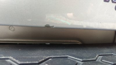

Now things get worse though.... When re-aligning the rear bumper, I realized they put a large chip in the paint on the very bottom of my tailgate. Now....I'm really pissed. I just spent 4 hours cleaning the outside of my truck before I dropped it off. I know every mark on the truck and know it wasn't there. The truck is as close to perfect condition as you can get. I park the truck and take one of the cars to work the next day, thinking I would talk to the owner about the problems, but never did get him on the phone. The following day, I took the truck to work. On the way home, I get a turn signal bulb out on my dash... then it went off. When I stopped, I turned on the turn signals and looked at the front of the truck to find out my projector headlights and the high beam bulbs were flashing like a turn signal. Unbelievable....they screwed up plugging the lights back together too! Now, I need to pull the grill off and remove the headlights to fix it.

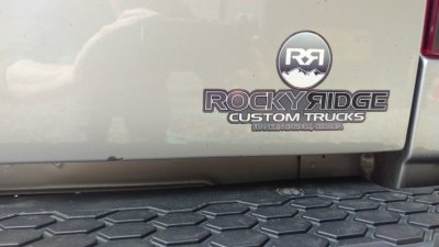

So I fixed the rear bumper alignment last weekend and today I removed the grill and headlights to fix the wiring. The more I look at the work this place did, the more I realize how bad they really are. There's a removable panel in each front wheel well to access a sliding plastic clip that locks each headlight in. On one side, the plastic clip was in the locked position....on the other side, they never moved the clip to the lock position. So. I remove the headlights to get to the wiring, which are harness' I bought from Retroshop for my projector headlights. There's two connections on each side that plug into the wiring from the headlights.....both sides were crossed....plugged to the wrong connector. After switching the plugs, everything works fine again. But, for anyone familiar with these plugs, there's a red plastic slide lock on the connector. On one side, they never slid either of the locks to the locked position after plugging it in. This place couldn't even plug a connector together properly. WTF!
I attached a pic of the rear bumper out of alignment from before I fixed it. The pic doesn't show how bad it was with the space between the body. I also attached a couple pics of the giant chip out of the tailgate. All I can say is worst place ever. I don't care who says they had a good experience there....this place is horrible.

When I talked to the owner there, he did say "bring your truck back in and we'll take care of the headlights and bumper". But, there's no way I'd ever drop the truck off there again. If that many things were bad the first time, who knows what they would do the next time. So I ended up fixing the bumper and headlight wiring myself. I'm still trying to figure out what to do with the paint on the tailgate. I have color matched paint from Dr. Colorchip for my truck. I'm going to try that this weekend. I think the issue I'm going to run into is how deep the chip is...I don't think it will ever fill it high enough to match the rest of the tailgate. And, I was hoping not to re-paint the tailgate. It has a couple Rocky Ridge stickers on it, one of which is probably impossible to replace. It's a "Phantom" edition from RR, but they no longer make that edition...so I doubt they still have the logos for it.
