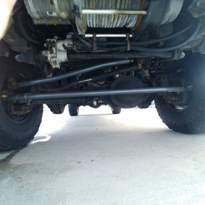

Just in from the cold. Checked torque on the trackbar... both mounting bolts are over 215 ft lbs, so that is not it. Feeling like it has to be something stupid at this point, since I have checked everything I can think of.
The only other thing I have been thinking about are all of the radius arm bushings, which I doubt would be the issue. But could "justify" going to a 4 link setup. ; )

Just a thought. That track bar is adjustable? If it's was the drivers side giving you issues. Check the length on the track bar. Did it come out of adjustment. Look at the front of your truck. Does it look like the axle is further to the ds or ps then the other.
Yep, fully adjustable trackbar. I will definitely check for that. Thanks.
