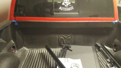

Tips: Decided to make a tip thread since there are plenty of install videos on YouTube and the included instructions are clear. These steps are to be used before installing the rail clamps.
1. In order to get the rails to properly fit, you must cut the drop in plastic cover near the cab and on the tailgate just a bit to get a proper seal, otherwise you'll have a gap which would leak.
2. The plastic is thick, so a dremel or torch and sharp razor will be needed.
3. Place rail and outline wear you need to cut using painters tape or a visible marker.
4. To prevent damage (scratches and cutting into the bed), pull up and pull back on the liner near the cab to give yourself clearance to cut the liner.

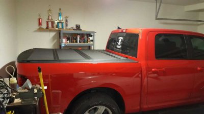

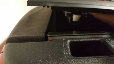

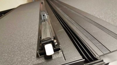

Review: Overall satisfied with my purchase. The package comes with pretty good instructions and i was able to do everything on my own in the garage. The MX4 provides a secure, weather resistant, and stylish finish. The one feature that caught my attention is... this the only hard tri-folding tonneua cover that allows you to close the tailgate without lifting the last section. The last few pictures shows how cover seal against the tailgate. There are 3 strips of weather stripping that seals to the tailgate when you close it.

More pictures since I was limited to 5 in the original post
