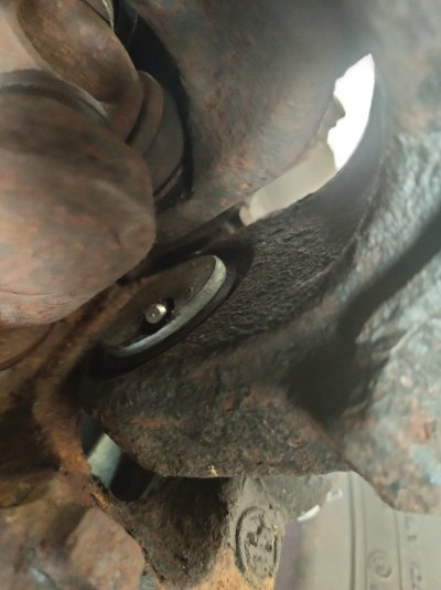

I've got this zerk on my lower ball joint and I can't for the life of me find the right fitting to put on my grease gun to grease it. Any recommendations? A standard fitting that just goes over the zerk won't work because it's recessed a bit in the ball joint. Is there a narrow fitting someone knows of that can fit in there? 0a10eaf7c23194830bc24595a86ba45a.jpge8b8c13b5dbd5d3fe76f89ee4a0ec6f9.jpg

Looks like a Carli joint. A standard one should fit. Might have to turn that ujoint a bit to get it positioned right.

Use agrease needle attached to your grease gun. Ya just press the ball in on the zerk with the needle tip and pump the grease to it.

Yae, There's a grease pump gun that has that special fitting on the end they use them on motorcycle's allot, you have to hold it on the fitting and pump it in.
