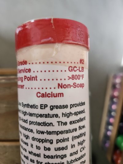

Red Line CV-2. Years ago, back east, I used a Drydene Purple grease that held up better in forklift kingpins, and loader/backhoe pins than anything else by far, at the time.
Doesn't say what the soap thickener is, nor does the SDS. All it says it so "thoroughly clean out lubricated joints prior to use". Most factory equipment comes with lithium complex soap thickener greases. And now that Red Line moved and Rep. Dave Granlund retired, I wouldn't risk using it without knowing what it is.
