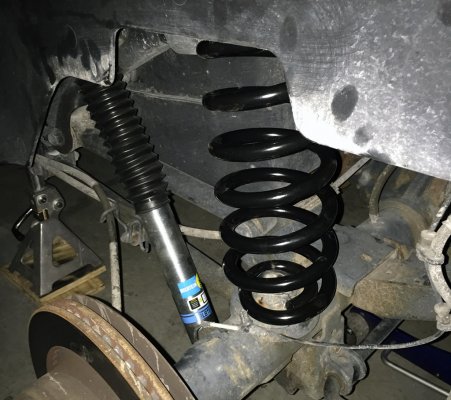

I had a Hellbent Steel 2.5 spacer first. I have since removed it, and did the Bilsteins last Sunday set at 2.8.
To be honest, the hardest part of the front end job has got to be compressing the springs. My air wrench only helped to a point and then the rest was by hand. I'd be curious to know how much it costs to do the fronts to see what my time would of been worth.
The 1223 did raise my rear. The truck shop that did my tires were joking that "she had her ass in the air" today.

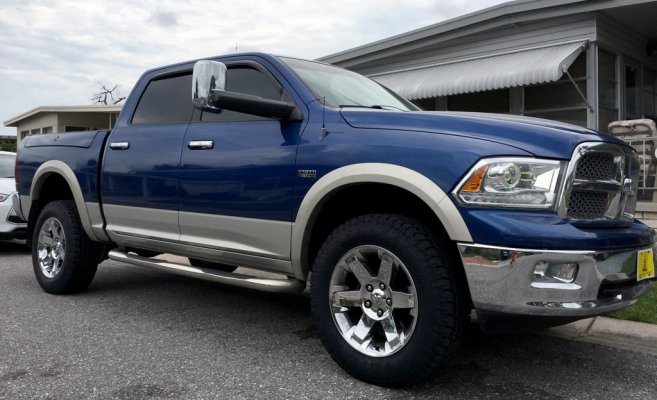

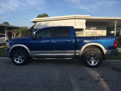

My Signature picture is only with the HBS level.

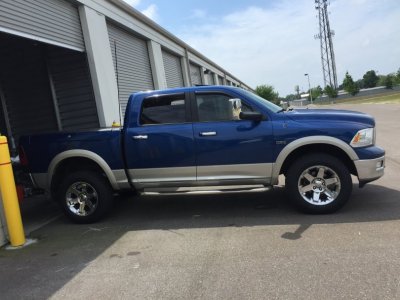

This is a picture from today. I have upgraded the tires to 275/65R20 which is 1 inch larger than stock, E-rated tire.
Jack went here:
New rear springs:
Fronts at 2.8
I haven't taken measurements yet, but I should. I'll have to post them up for reference.

I'm 5'8 and the wife took this photo last night, and this is before the tires today.

She is ass up. :roflsquared:
Front is 39 even and the rear is 43 1/2 inches.
