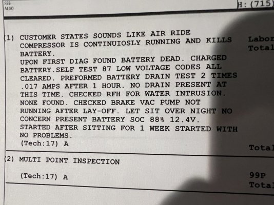

Well, here is the rest of the story….. I received a call yesterday from the service dept. He told me that they did a number of tests and can’t find anything. Then I was told I can pick it up. The bill was $650! I asked for what?! The response was the tests that were done and labor. I told him that ai would be contacting the owner regarding the charge. The owner called me back. He said the cost was labor. I once again said- with no results? Then I asked -what if this happens again? Response was-bring it in and we will see what we can do. after negotiation he reduced the bill to $350. I understand that they have to pay the mechanic and have labor cost, but this is so frustrating. I picked up my truck and drove it yesterday. It seemed to run fine. But that happened before when I replaced the battery and three weeks later the issue arose. Not much I can do at this point, except pray that it was an isolated event. I attached the section of the bill to show what was done. Anyone have further thoughts on this attachment?
Wow!
Did they have any explanation for your video-captured observations?
I'm sorry to hear that they didn't find anything.
I suggest you learn the location of the air suspension compressor and booster pump fuses and plan to remove the fuses the next time you hear the noise in the video.
The TIPM (fuse box in the engine bay) fuse #F17 air suspension, F22 air suspension control module, F33 brake booster vacuum pump.
Maybe, raise the hood, set the air suspension compressor to run, and jump out to listen if the noise is the same as your video. That would confirm or rule out the suspension compressor as being the source of your grief.
Until you have identified the culprit, I'd be carrying a 10mm wrench and be prepared to remove the negative battery terminal any time you hear that compressor-like noise, after a shutdown.
Another question for clarification, when the video of that noise was recorded, was that with the key off?
I don't believe either of those devices should be running in a key-off state. If they are, we have to question why they're not connected to a switched fuse, meaning they have no power when the key switch is in an off state.
I was having a similar issue. I had airbags added to my Ram 3500 and the major company that installed them hooked them up to an always on fuse. I finally figured it out and hooked them up to a switched fuse and never had the problem again.
If that noise is only heard with the key off, once we can identify the device and move it to a switched fuse, you should be good to go.

The video was taken when I opened the hood waiting for the tow truck. He thought he may be able to jump it. The start button was not touched. The noise began after I shut the truck off.
I do plan to check fuses if it happens again. I will pull the fuses you mentioned one at a time to see if the noise stops. Thank you for the reminder of the wrench. Sad to think you need to carry a wrench thinking it will happen again. I appreciate everyone’s support, thoughts and input.

I would suggest you consider being a bit more proactive than just waiting.
You might prefer to deal with this on your schedule rather than wait because, I can almost guarantee that when the problem returns, it won't be convenient.
It wouldn't take much effort to test the air suspension compressor, as previously described, to potentially identify the culprit.
If you learn that it is the source of the noise you recorded, that's a big red flag, that it is wrongly connected to an unswitched power source. That would be relatively easy to correct.
If it is the suspension compressor, as a short-term, stopgap solution, I'd pull the associated fuse when you park until you can move it to a switched power source.
If I were you, I would also have a look at the fuses identified above, at your next convenience. Then at least, you know exactly where to look when it starts misbehaving again.
